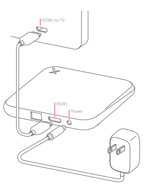

Use the guide below for instructions on how to connect this receiver to a TV.
The Panoramic Wifi Gateway must be installed and the internet working prior to connecting the receiver.
Contour Wireless CiOne Receiver Connection Guide (PNG)

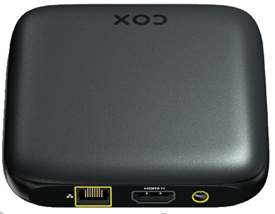

Back View
Arris Xi6 MoCA and IP HD receiver back panel diagram showing ethernet port, HDMI ports, and power.
From left to right, review the table below for a description of the connection ports.
Color Symbol Description Active
Yellow Box Three dots in a triangle Ethernet Port Yes
Blue Outline HD to TV HDMI Out Yes
Yellow Circle None Power Connection Yes
